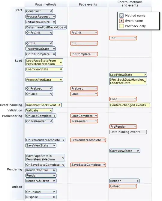

Could you try adding the INamingContainer to your webpart? The postback data is serialized and the INamingContainer tells the ASP.NET engine to make this control as part of the postback. The ID does need to be set, otherwise the engine cannot match postback data when firing the events. a normal webpart should already have this though from 1 of it's base classes, but still, give it a try.
PS, opposed to what Nitin says, controls should NOT be created in the Init override but in the CreateChildControls override, that's what it's there for :-D. For more info, read up on the ASP.NET Page Life cycle:
ASP.NET Page life cycle
