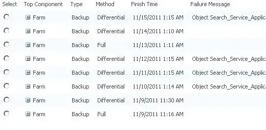

Edit:
Screenshot
It appears that after a full backup was performed on Sunday morning, and a differential successfully on Monday morning, but this morning, it failed with the same error. Hope this helps?

  • What does your full backup script look like? My assumption it is more or less the same as your differential but with the -BackupMethod full instead. Assuming the full backup has run previously, check the logs to see if the configuration database was backed up (maybe there was an error), as the error suggests it has not. – shufler Nov 14 '11 at 20:58
  • @shufler: Correct, my full script is exactly the same, but obviously changing the backup method to Full instead of Differential. When running via the powershell, it works fine but I get an error when it's done via the task scheduler, which is running on the same user. What is strange, is a full backup was performed on Sunday morning and a differential Monday morning fine, but this mornings differential again complains about the lack of a full backup. Odd... – Gavin Nov 15 '11 at 12:04
  • Gavin, I noticed the first error you pasted is a SQL Exception on the configuration DB, but in your edit the failure message is "Object Search_Service_Applic..." -- are there different errors happening with the backups? – shufler Nov 16 '11 at 00:14
  • @shufler: Yes, it seems every database the backup attempts to "backup" displays the same error. See the latest log at: http://pastebin.com/6NGtQQUC. You will see the SQLException you talk of appear as a Warning and as a Fatal error for a lot of databases. Yet, the same differential script ran with no errors after performing a full backup the day before. Thanks for your help ;) – Gavin Nov 16 '11 at 12:41
  • Hi @Gavin, I ran into the same problem (I used the same solution you mentioned above, but I'm using a different Powershell script), my backup has worked fine for 6 months, but recently started erroring much in the same way. Did you ever find a solution? If so, you remember what? :) Thx! – ewitkows May 30 '13 at 17:54
