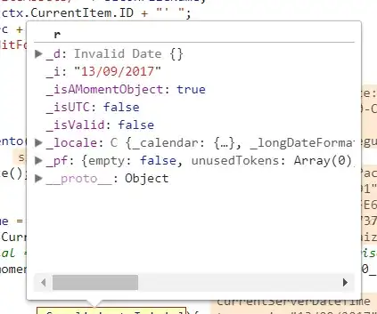

UPDATE: As comments below I try to do it using
 var sCumplimientoInicial = moment("ctx.CurrentItem.Fecha_x0020_Compromiso_x0020_Ini");
But I getting "Invalid Date"

  • I try it but I get Invalid date into my field... format of my field is "dd/mm/yyyy" – Ledwing Oct 03 '17 at 23:41
  • check the updated answer! – Mohamed El-Qassas MVP Oct 03 '17 at 23:50
  • I try it, but same result, check my update in my question – Ledwing Oct 04 '17 at 00:05
  • Date.parse work but I don´t know why it works because their output are numbers not formated date, so I´m comparing a date formated as "dd/mm/yyyy" with parse date like 1509001200000, can you explain how it works? – Ledwing Oct 04 '17 at 05:07
