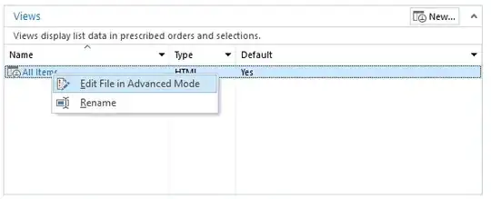

If I understand your requirement correctly, you want to have the link and ellipsis to another column. Yes, this can be achieved through SharePoint Designer. Right click All Items Under Views and Edit File in Advanced Mode
<FieldRef Name="CellPhone" listItemMenu="TRUE" linkToItem="TRUE"/>
Copy and Paste listItemMenu="TRUE" linkToItem="TRUE" to the desired FieldRef column. Somehow linkToItem is case sensitive. I don't why but it didn't work for me if I change case.

  • Can you show me the path to get to this source code from SharePoint Designer? I don't believe I have access to it, which is why I am asking. – Lasagna Cat Jun 14 '17 at 23:01
  • I have updated my answer. you will need to edit the file in advanced mode. See the screenshot – SharePointer Jun 14 '17 at 23:05
  • Thank you for the instructions. When I try to follow them and right click "All Items" under the "View" tab, I only have the option to "Rename", as there are no "Edit File in Advanced Mode" option. Here is my screenshot http://i.imgur.com/NHXmieJ.png – Lasagna Cat Jun 26 '17 at 17:03
