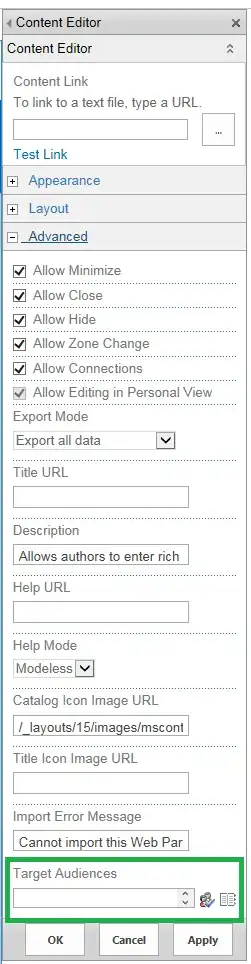

here's where you can find Audience Targeting, which is what I would use here:
  1. Edit the page
  2. Click the little arrow in the top-right corner of the web part and select Edit Web Part
  3. In the web part properties that you should now see on the right of the page, expand the Advanced block of options.
  4. At the bottom of this section is Target Audiences (see below). Here you can add the group of users who should see the button to grant them visibility.
Give this a try - hope it helps!
Target Audiences
