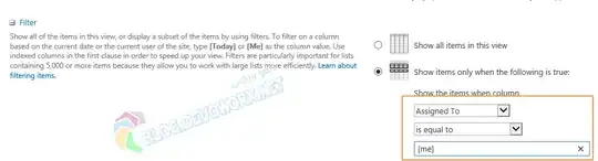

Whatever you are using task list or custom list, I don't think you need to use javascript to achieve your requirements also you can't add a button to each view simply as OOTB. you will need to customize it.
So my suggestions get the total items based on the login user as the following:
  • Open your list > select your view > from the above ribbon click on modify view.
  • At filter section > select the assigned to field equal to [me] enter image description here
  • At total section > Count with any column as you need.
[Output]
Regarding other views you can repeat the above steps,
Regarding new views you can create a view from existing view that has the same configuration and starts from it :)

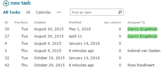

Use the WYSIWIG Cisar editor
Create a CSR - Client Side Rendering file that highlights (green) the Items Assigned To the current user
This is all CSR code required:

JavaScript Notes:
  • user and color variables are not declared, so JS hoists them to local variables within the function
  • the user.id is a string, while the userId is Number, comparing with == works fine, while comparing with === will not
  • String.format is provided by SharePoint SP.js code, it can do lots more
    see: Changing date format using javascript
It gets you colors in the View
Notes
  • you do have to add the file to the JSLink definition of every view (open Cisar in every View and link your file, Cisar creates the JSLinks for you)
  • If you execute the JS file as UserCustomAction (or load it in the MasterPage), it will be applied to every AssignedTo field in every View
