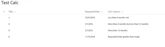

Create calculated column with following formula :
=IF([Requested Date]>TODAY(),"Requested Date greater than today",IF([Requested Date]>TODAY()-180,"Less than 6 months old",IF([Requested Date]>TODAY()-365,"More than 6 months but less than 12 months","More than 12 months")))
Note : we can only compare with days not months so used 180 (for 6 months) and 365 (for 12 months).
in your question one condition is missing : If "requested date" is greater than today, so i have added then condition.
Here is the end result :
Monica Jagani

  • Wait a couple of hours till the clock says its the next day.. And you will notice this Formula is now one day off so it does not work. --> http://sharepoint.stackexchange.com/questions/151144/how-to-use-today-and-me-in-calculated-column/151336#151336 – Danny '365CSI' Engelman Nov 08 '16 at 09:10
  • If the calculation needs to be static based on the date it was entered then above solution will wok. If it needs to be dynamic, then like you said it won't work. It depends on the requirement. – Monica Jagani Nov 08 '16 at 09:40
  • Yes.. but.. when you re edit the formula ALL the ListItems will update and thus ALL those today()s will update.. If you want date entered use Created or Modified for changed – Danny '365CSI' Engelman Nov 08 '16 at 11:11
  • I have tried the code above and it works for what I need. The calculation can be static. Im not looking for the times to change, just something as a quick reference as to how old the record is. these records get updated all of the time so the formula will refresh. Thank you very much. – TroyMike518 Nov 08 '16 at 15:38
