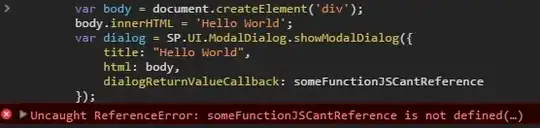

Likely your RefreshOnDialogClose can't be referenced.
Have you checked your browsers console?
This happens when I'm correct:
Following snippet works if you get all required JS frameworks (sp.js, sp.ui.dialog.js)
    var body = document.createElement('div');
    body.innerHTML = 'Hello World';
    var dialog = SP.UI.ModalDialog.showModalDialog({
        title: "Hello World",
        html: body,
        dialogReturnValueCallback: function (dialogResult, result) {
            alert('hello world!');
            debugger;
