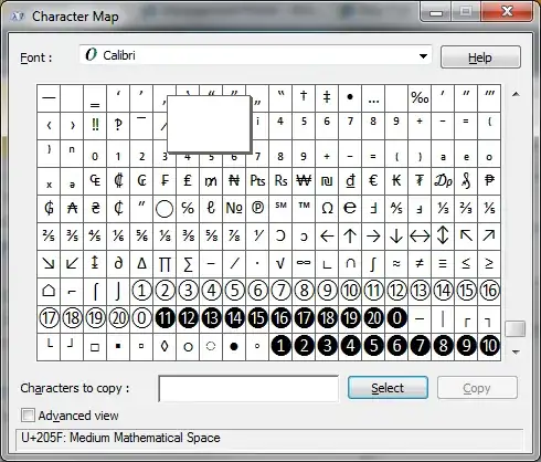

You could use a unicode character that does not print anything. I tried it with U+205F and it seemed to work as expected. To put this character in, open up the charmap (Start->Run->charmap) on your machine, then select a font that has unicode support (I chose calibri), scroll almost to the bottom and find the U+205F. You can then double click the character and it will place it in the textbox below. You can then copy that value and put it in a choice field option and it will appear as blank to the user.
EDIT: Make sure you also put it in as the default value, otherwise you will get three choices (NULL, U+205F, and YES). Also, if you have any existing rows in the list, you will see three choices if the row has a null value currently assigned.
As you can see the test column now appears to have a blank option.

Are you typing "U+205F" in the field? Read the description of what I said above. Copy and paste using the Charmap to copy the value from the charmap and paste it in as an option and as the default value on your column. – John Koerner Sep 16 '11 at 17:42
@John: I can copy and paste it from charmap to both as an option and default value. oh well. I guess I will have to move on. Thanks for all you help. – Mary Rivers Sep 19 '11 at 13:10
