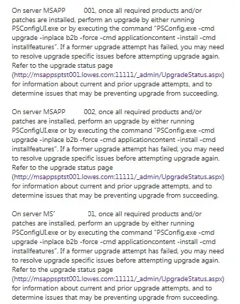

New Update - It was brought to my attention that the Patching team did some Security Patch installs and I am getting below errors in the CA enter image description hereenter image description here
Do I run PSConfig.exe -cmd upgrade -inplace b2b -force -cmd applicationcontent -install -cmd installfeatures

  • This issue is still not fixed and looks like patching team did some installs and it still throws the errors in CA.I just don't want to run the PSConfig and if it fails it will bring down the CA. Do I still run the Get-SPContentDatabase | ?{$_.NeedsUpgrade -eq $true} | Upgrade-SPContentDatabase – SavantProdigy Aug 04 '16 at 21:02
  • Thanks for the response, I ran this before seeing your message and got the error(latest screenshot). I ran this PSConfig.exe -cmd upgrade -inplace b2b -force -cmd applicationcontent -install -cmd installfeatures. I will try running the SPContentDatabase | ?{$_.NeedsUpgrade -eq $true} | Upgrade-SPContentDatabase. Sorry :( – SavantProdigy Aug 05 '16 at 00:57
  • All my DB's are upgraded except the IT DB(Screenshot) not sure what that error is.My CA is also down what do I do next. – SavantProdigy Aug 05 '16 at 21:58
  • Did you run ps config on all SharePoint servers ? if yes try to dismount this database then run ps config to all SharePoint servers to let CA up , then mount database again to web application and upgrade it – Mohamed El-Qassas MVP Aug 06 '16 at 09:07
  • No I didn't run it on all I just ran it on one and it threw the error and I stopped, do I unmount the CA DB or all DB's then run PSConfig and mount it back. – SavantProdigy Aug 08 '16 at 14:57
  • Finally ran the psconfig.exe -cmd upgrade -inplace b2b -wait force most of the DB were upgraded except few and the ones that errored out were actually corrupted and had to be detached from QA and restored from PROD – SavantProdigy Aug 09 '16 at 00:49

  • Sarwar My Patching Team did some security installs on different weekends and looks like I get the above errors in CA I looked at the Upgrade Logs but its not very helpful, do I try running Get-SPContentDatabase | ?{$_.NeedsUpgrade -eq $true} | Upgrade-SPContentDatabase If this fails will that bring the CA down. – SavantProdigy Aug 04 '16 at 21:05
  • if they did the Security patches and DB status saying Upgrade required, then you have to Run the PSconfig Wizard. it will fix the issue....the command you mentioned will upgrade the Content DB and not impact the CA. But still uneed config wizard – Waqas Sarwar MVP Aug 04 '16 at 21:07
  • is there a order in which I run the PSConfig or just run it on the server hosting the CA or it has to be run in all the servers throwing errors. – SavantProdigy Aug 04 '16 at 21:14
  • it has to be run on all servers one by one, I would start from the CA followed by others – Waqas Sarwar MVP Aug 04 '16 at 21:15
