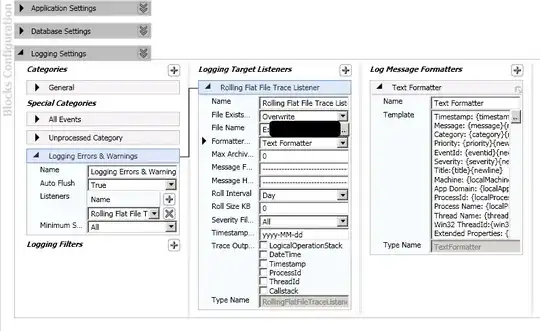

+1 for ULS. But if you use Enterprise Library (or one of its components) it also provides very flexible and easy way to configure logging.
