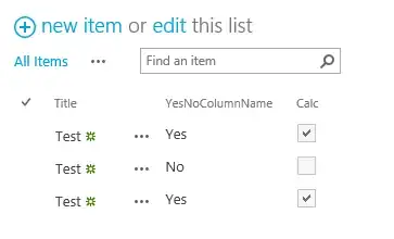

You can always add a calculated column to your list and show an image based if the column is "Yes" or "No" in the list view instead of having the column with the actual text value "Yes" and "No" displaying..
There are existing check box icons in SharePoint 2010 which might suit you.
For an example you can use existing images ( or use any of your own ) in a calculated column based on the type number and add this:
=IF(YesNoColumnName=TRUE;"<img src='http://SharePointUrl/_layouts/images/cbChecked_locked.GIF' border='0'/>";"<img src='http://SharePointUrl/_layouts/images/cbUnChecked.GIF' border='0'/>")
This is the result based on what i used in the column "YesNoColumnName". ( Yes, i did it in 2013, but the images exist in 2010. )
Or you can create a calculated column and display any value based on the yes no column.
=IF(YesNoColumnName=TRUE,"This is the text when the column is Yes","This is the text when the column is No")
One additional note is that based on your regional setting in SharePoint, you might need to replace all ";" characters with a "," or vice versa.
