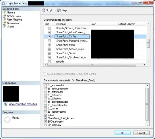

Found it. My account needed proper rights in SQL Server, per this post:
The local farm is not accessible. Cmdlets with FeatureDependencyId are not registered.
It worked once I set "Sharepoint_Shell_Access" to the Sharepoint_Config database.
What got me here was searching for the first message: "the local farm is not accessible"
