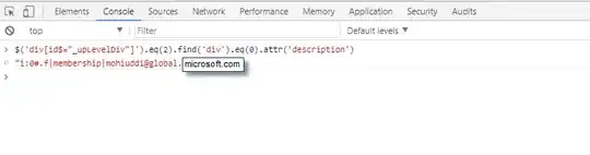

You are smart when you have jQuery with you.
$('div[id$="_upLevelDiv"]').eq(2).find('div').eq(0).attr('description')
I have used index because I have more than two peoplePicker in my form. I have captured the third $('div[id$="_upLevelDiv"]').eq(2) people picker resolved value.
