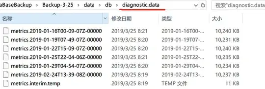

We accidentally deleted the directory rm -rf /data/db which was our MongoDB path, and thanks to extundelete, we recovered it and got the directory /data/db.
Here are our files in the directory, and the files was generated under MongoDB version 3.4.
Folder diagnostic.data:
Folder journal:
Folder journal

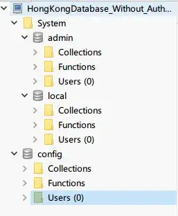

a) We ran mongod --port 27017 --dbpath /data/db --bind_ip_all and mongo, and expected there should have a user-defined database wecaXX, But, it did not show up.
> show dbs
admin   0.000GB
config  0.000GB
local   0.000GB
In Robo3T

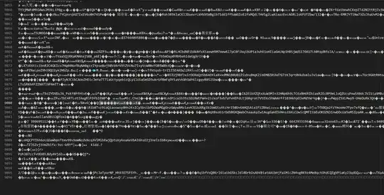

The snapshot of collection-23--360946650994865928.wt just has been salvaged.
We could see some English or Chinese characters in it. And that data truly is from one of collection of database wecaXX.

2) collection-23--360946650994865928.wt contains our most important data. If we could not restore the whole database, extracting data from that file will be still very useful. However, if we do copy paste manually, not all the characters are well written; they still need to be decrypted. Does anyone know how to do that?
