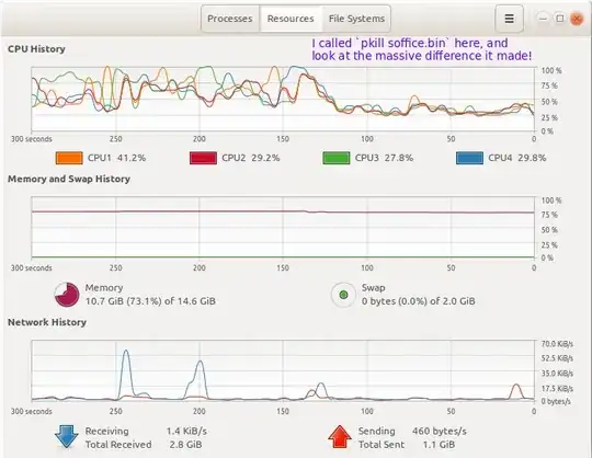

No idea why it's happening, but it's bothering me like crazy too. Essentially, LibreOffice is taking up 100% of one core all the time, even when everything is minimized and it's just sitting there!
Meanwhile, here's a workaround to fix it:
  1. SAVE ALL YOUR OPEN DOCUMENTS.
  2. Then, with them still open, go to a terminal and type pkill soffice.bin. This kills the out-of-control process.
  3. Re-open LibreOffice. Let it auto-recover your open documents, and you can now continue working.
You may have to do this every time you have the problem. It's not a permanent fix.
Here's a screenshot showing before doing pkill, and after. Note that even after reopening libreoffice after doing the pkill command, my CPU usage still stayed very low just like it's shown here at the right. In other words, reopening libreoffice did NOT cause the bad CPU behavior again.
