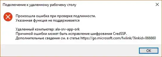

6) And that is the error I get when I try to RDP to NLA-enabled server. So client for some reason can't or won't willingly use CredSSP. It worked a week before so I think it's connected to cert problem.
And that is the error I get when I try to RDP to NLA-enabled server. So client for some reason can't or won't willingly use CredSSP. I think it's connected to cert problem.

  • Can you please translate yellow exclamation marks from 1st image, and error message from 4th image? I see creessp problem in 4th image, so it may be: https://serverfault.com/questions/911590/this-could-be-due-to-credssp-encryption-oracle-remediation-rdp-to-windows-10-p/911595#911595 – Michal Sokolowski May 14 '18 at 07:46
  • As far as I remember, you need to install CA cert and valid CRL in local computer certificate storage (client side), not in personal. – Michal Sokolowski May 14 '18 at 07:55
  • Wrong server name in certificate (in cert is FDQN, but I addressed server by name without domain part) and Cert issued by not trusted CA 2) 4th image says that function is not supported (implying that CredSSP in not enabled)
  • – user2838376 May 14 '18 at 07:56
  • It's local computer storage, not personal account. – user2838376 May 14 '18 at 08:00
  • So you have to update client and server to get rid of CredSPP thing (details in the linka above), enable NLA and reboot. Make sure that installed certificate has the same fingerprint as the certificate exposed to client. – Michal Sokolowski May 14 '18 at 08:03
