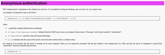

However, if you can ldapsearch with some anonymous request (with -x) just before, I suppose that's an acceptable way to check.
If I refer myself to this previous post How to test a LDAP connection from a client, the test you're currently using should be fine. (considering it was working before, and it's a connectivity issue, and not a misconfiguration)
Make yourself sure that anonymous authentication are enable, and you can actually query the AD with it.
