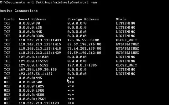

I know that 127.0.0.1 ~ 127.255.255.254 are the loopback IP addresses for most modern operating systems, and these IP addresses can be used to refer to our own computer.
But what's 0.0.0.0? It seems it also refers to the local computer, so what's the difference?
And, could you explain the following IP connections for me:
screenshot of netstat -an output

The only thing is that you're not saying "all addresses should have access" -- that's done in your firewall(s) and/or the server software and/or other security layers like tcpwrappers.
0.0.0.0, in this context, means "all IP addresses on the local machine" (in fact probably, "all IPv4 addresses on the local machine"). So, if your web server machine has two IP addresses, 192.168.1.1 and 10.1.2.1, and you allow a web server daemon like Apache to listen on 0.0.0.0, it will be reachable at both of those IP addresses. But only to what can contact those IP addresses and the web port(s).
Note that, in a different context (routing) 0.0.0.0 usually means the default route (the route to "the rest of" the internet, aside from routes in your local network etc.).

When a service is listening on 0.0.0.0 this means the service is listening on all the configured network interfaces, when listening on 127.0.0.1 the service is only bound to the loopback interface (only available on the local machine)

The IP address 0.0.0.0 can have very different meanings, depending on where it's used.
  • It's not a valid address to be given to an actual network interface, along with any other address in the 0.0.0.0/8 subnet (i.e. any address starting with 0.).
  • It can't be used as the source address on any IP packet, unless this happens when a computer still doesn't know its own IP address and it's trying to acquire one (classic example: DHCP).
  • If used in a routing table, it identifies the default gateway; a route to 0.0.0.0 is the default one, i.e. the one used when there is not any more specific route available to a destination address.
  • Lastly, when seen in the output of the netstat command (which is what you asked for), it means that a given socket is listening on all the available IP addresses the computer has; when a computer has more than one IP address, a socket can be bound only to a specific address and port pair, or to a port and all addresses; if you see an IP address there, it means that socket is listening only on that port and that specific address; if you see 0.0.0.0, it means it's listening on that port on all addresses of the machine, including the loopback one (127.0.0.1).

The difference between 0.0.0.0 and the loopback address 127.0.0.1 is that the loopback address is designed to allow a fully functioning IP interface within the host itself, regardless of what the rest of the networking setup, if any, looks like. Any traffic sent to the loopback device is immediately received on it. It's not so much that the loopback network "refers" to your own host... it's more of like you have a mini network segment in your host that devices, processes and sockets and can open and connect to.
In simple terms: Listening on 0.0.0.0 means listening from anywhere that has network access to this computer, for example, from this very computer, from local network or from the Internet, while listening on 127.0.0.1 means only listen from this very computer
