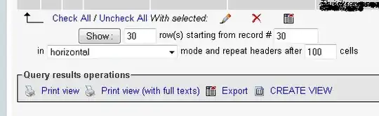

Instead of the export button at the top of the GUI, use the one at the bottom, within the "Query results operations" box. That is the one you want.
Export button
  • I had uploaded a picture here as well - wonder where it went.

    Thanks! In the current interface there's yet another incorrect "export" button, right about the "query results operations" box. The screenshot is helpful. – octern Feb 07 '13 at 19:43
