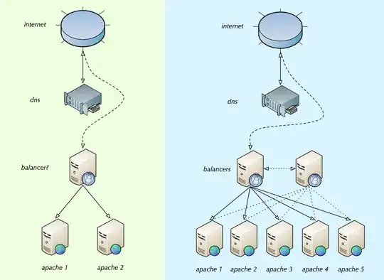

I am looking to use something like Heartbeat/Squid/Varnish/etc to balance the amount of incoming traffic amongst the internal apache instances. This would have to be software and not hardware as all my stuff is run on VPS. I don't have a lot of experience in this area so sorry if I am misusing terminology and picking the wrong packages.
I have drawn up something to illustrate what I am after. The green side is what the initial setup would look like and the blue side is what it might look like after adding more apache instances due to traffic increase. This might not be how these things work, but Ideally I would add the IP of the balancer/s to the DNS of the domain. Then the balancer/s would see how many connections are on each apache instance (via some config list of internal IP's or eternal IPs) and distributes the connections equally. In the blue there is a second balancer as I am sure at some point the balancer would need help too.
Maybe I am going about this wrong, but I am looking for help on what the "balancer/s" should be and best practices on how to set them up.
Any help would be great. alt text

Jackie, you've pretty much nailed it. Your illustration shows how load balancing is handled on most smaller and midsized installations.
Well, sure. But load balancing is simple, and often a single load balancer can go fast. I link to this article, which struck a nerve in the web, as just an example of what performance ballpark a single modern server can provide. Don't use multiple LB's before you need to. When you need to a common approach is IP level load balancers at the very front (or DNS Round Robin), going to HTTP level load balancers, going to proxies & webapp servers.
