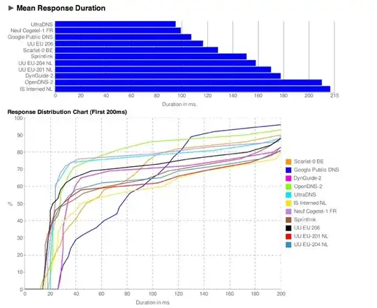

There is a useful tool that test the different DNS nameservers available (your ISP, current configuration, DynDNS, Google Public DNS and other one).
From my point of view Google DNS are pretty fast but depending on the load GoogleDNS supports my ISP Dns is sometimes faster.
NameBench (Linux/Windows/Mac OS X)
Output : alt text
(source: googlecode.com)
