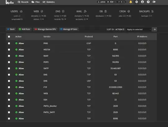

and apparently HestiaCP uses Iptables as firewall.
I found the "Firewall" in HestiaCP
I have opened port 8085
and service hestia restart service apache2 restart

LISTEN 0 511 78.110.163.102:8080 0.0.0.0:* users:(("apache2",pid=75104,fd=5),("apache2",pid=75103,fd=5),("apache2",pid=75102,fd=5),("apache2",pid=75101,fd=5))
LISTEN 0 511 127.0.0.1:8081 0.0.0.0:* users:(("apache2",pid=75104,fd=3),("apache2",pid=75103,fd=3),("apache2",pid=75102,fd=3),("apache2",pid=75101,fd=3))
LISTEN 0 511 94.46.186.222:8443 0.0.0.0:* users:(("apache2",pid=75104,fd=8),("apache2",pid=75103,fd=8),("apache2",pid=75102,fd=8),("apache2",pid=75101,fd=8))
LISTEN 0 511 78.157.211.222:8443 0.0.0.0:* users:(("apache2",pid=75104,fd=6),("apache2",pid=75103,fd=6),("apache2",pid=75102,fd=6),("apache2",pid=75101,fd=6))
LISTEN 0 511 78.110.163.102:8443 0.0.0.0:* users:(("apache2",pid=75104,fd=4),("apache2",pid=75103,fd=4),("apache2",pid=75102,fd=4),("apache2",pid=75101,fd=4))
root@expressresponse:~#
- what have I missed ?
root@expressresponse:~# telnet localhost 8085
Trying ::1...
Trying 127.0.0.1...
telnet: Unable to connect to remote host: Connection refused
How do I get 127.0.0.1:8085 opened and listened to ?
Thanks Dave.
