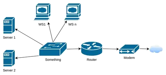

Here is what I have: An N number of workstations that are communicating with private servers. Server 1 is production and server 2 is backup. Usually none of them will need internet access to work.
In case Server 1 fail. User will turn on backup server and workstations must automatically start using it (they are running standard web browser).
At any moment I should be able to SSH from internet to both server 1 and/or 2 for maintenance.
Each server have up to 3 spare ports if I need more than 1 connection/network.
For this what should I use for the "something" device? Or is this whole architecture wrong for may needs?

  • "something" is probably a load balancer. You would point your workstations to a single IP per application then it would be responsibility of this device to monitor Server 1 & 2 and direct traffic to the appropriate server. You might also be able to setup some VIPs (shared IPs) on the servers and forego the idea of a "something" device. But that's dependent on the OS and application, and IMHO much more complicated than running a load balancer. – Brandon Xavier Jun 06 '22 at 19:31
"Something" need to be a load balancer - HAProxy would do the job. You simply add both "Server 1" and "Server 2" and check if first is not working and move your traffic to back up. Here is a example HAProxy config:
frontend web
bind :80 option httplog option forwardfor except 127.0.0.1 option forwardfor header X-Real-IP acl is-correct-address hdr_dom(host) -i something.server.dns.address acl is-production-offline nbsrv(production) lt 1 use_backend backup if is-correct-address is-production-offline use_backend production if is-correct-address backend production mode http server server-1 10.0.0.1:80 backend backup mode http server server-2 10.0.0.2:80
