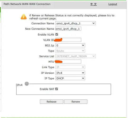

Then I added this port forwarding setting (I saw it on YouTube tutorial). I'm not very sure if it's correct or not.
And here is network status:
But it made no difference. Am I doing something wrong?

first check if your ISP doesn't user GCNAT and provides you with a real IP address. then you need to configure a firewall and port forwarding your router. Don't do all port range from 1 to 65535, configure only ports you need.
yourrounter_IP:8080 => localserver_IP:8080

  • https://i.stack.imgur.com/grnIo.jpg – Vikas Apr 24 '22 at 10:51
  • I think the problem is GCNAT. In this screenshot, you see 100.100.x.x IP which is different from public IP. Right? – Vikas Apr 24 '22 at 10:52
  • yep, CGNAT subnet is 100.64.0.0/10 - from 100.64.0.0 to 100.127.255.255. Usually ISPs provide a public IP address as an additional service – 4snok Apr 25 '22 at 00:27
