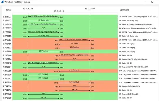

I am setting up some new switches and VLANs and I am getting trouble with our pre-existing Asterisk VoIP set-up.
Most calls work ok. Some get just one-way audio. I tried to narrow it down to this specific test situation:
Asterisk server is 10.0.10.10.
Call that works ok:
If phone 10.0.2.183 calls phone on 10.0.10.47, audio flows well both ways. This working call is depicted in this Wireshark diagram: Capture of call that works well both ways
Call that gets only one-way audio:
If instead, I swap the situation and initiate from the other phone, i.e. phone 10.0.10.47 calls phone on 10.0.2.183, audio flows only one-way: 10.0.2.183 can't hear 10.0.10.47. This faulty call is depicted in this Wireshark diagram:
NAT?

Any ideas on how to troubleshoot this? Why is everything going through except some very specific bits of RTP traffic? Thanks in advance for you help.

    This seems to be a SIP issue. The SIP invite is telling the phone to send RTP traffic to 10.0.0.1 (was the old asterisk server address) instead of 10.0.10.10 (new one). I can't figure out where in asterisk I can change this, but I will keep looking. – pgr May 10 '21 at 14:31
Just to leave some information regarding how I eventually solved this...
My reasoning was: if the SIP negotiation was successful, as made obvious by the packet captures, then it really wasn't a routing or firewall problem. I mean, it could still be a firewall problem, if it was letting some things through but not others (like other ports etc). But since I knew my rules were generic enough, if these devices could find routes to each other and talk to each other, this wasn't the cause of my issue.
This was made obvious by starting the call from the other phone instead. The RTP traffic flows, it routes, it passes the firewall.
So I should be focusing on SIP issues, how the choices for RTP traffic destinations are made. Eventually I had a break-through by thinking the packets are getting sent somewhere, so where are they getting sent to?. I went looking (with tcpdump) and I found them reaching the UDM on 10.0.0.1 instead of 10.0.10.10.
Inspecting the contents of those SIP INVITE packets you see in the Wireshark diagrams above, I actually found references to 10.0.0.1. Why? Because my Asterisk server thinks it's both 10.0.0.1 and 10.0.10.10 (two interfaces) but that is only true on the old topology, not on the new. So, despite me having configured both phones to use 10.0.10.10 as their SIP server, and despite the fact that they obey when starting the call from one side, and despite the fact that when starting it from the other side they are able to obey for SIP negotiation, one side still (!!!) ends up sending RTP traffic to the wrong address.
How to fix this properly: fix Asterisk configuration. I don't know how, and since this is a server about to go deprecated, and to which I don't have full access, I decided not to try this route.
How I actually fixed it: during the time when this asterisk server is going to be progressively phased out, I am re-routing UDP traffic on these specific RTP ports from 10.0.0.1 to 10.0.10.10. This was hard to achieve, but it works! Read about it here: Routing traffic for specific port range
