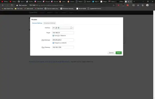

The last one in particular is the first thing that I tried, i.e. setting up a static route from the C7 to the V7610 like so:
Archer C7 static route settings
192.168.1.0 is my C7's network address, and the V7610 (192.168.2.0) is connected to it through 192.168.1.254. The cable that connects them runs between the WAN port of the V7610 and a LAN port of the C7.
All of this works great except for the issue mentioned in the title. For example, 192.168.1.2 can't communicate with 192.168.2.2. Connectivity between all nodes and the Internet is working fine.
This can't work, the WAN port is considered an external network, thus the V7610 will (at least by default) use NAT and firewalling to explicitly not allow incoming traffic from it to its iternal network.
I don't know the V7610 specs, but if it has a LAN port (which I hope it has) you should use that to connect the two devices, and then give them appropriate addresses (i.e. in the same IP subnet) on their LAN ports; then you can start thinking about routing.

  • While your first paragraph seems to make sense, your second does not. As I said, "the WAN port of the V7610 is connected to a LAN port of the C7", so yes, the C7 has a LAN port (four of them in fact) and it is being used for the router-to-router connection. – Kenny83 Nov 26 '20 at 11:49
  • I'm sorry, I got them mixed up; I meant you should use the LAN port on the V7610, too. Fixed it now. – Massimo Nov 26 '20 at 11:50
  • Thanks mate...it took 6 freaking hours and a massive hit to my self esteem but I've finally managed to do something so unbelievably simple that I should probably quit working in IT :P Now to add even more complexity into the mix, how would I set up an OpenVPN server on the C7 without undoing all my hard work?? MTIA! :D – Kenny83 Nov 26 '20 at 18:09
