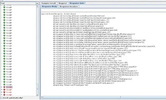

I am doing the API load testing using jmeter, here is the error from jmeter:
As you can see, the API should work fine and I have handled each exception inside isLogin API. So I don't think this error comes from my application. I guess it's related to infrastructure.
