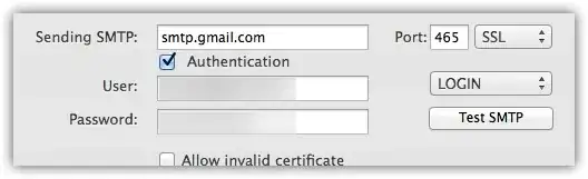

I was setting up a new email client Airmail 2.0 to use Google's SMTP server to send mail on behalf on a Gmail account.
Now, my setup might not be too "common": I have this specific Gmail address forwarded to a different address, which is the one I'm using from Airmail, and I'm setting the gmail address as an "alias" of that account. Likely to avoid looking like Spam, Airmail allows to configure a specific SMTP server to use when sending "from" an alias.
I have another Gmail account set up on Airmail without any "funky" configuration or redirections, and that one is working fine (no messages about "reduced security", for example). So I copied the SMTP settings from the "normal" account to the new one:
These are the settings for the "classical" account:
Old Gmail Account SMTP Settings
And these are the ones for the "alias" SMTP server:
New Gmail Account SMTP Settings
Notice any differences? Me neither!!
