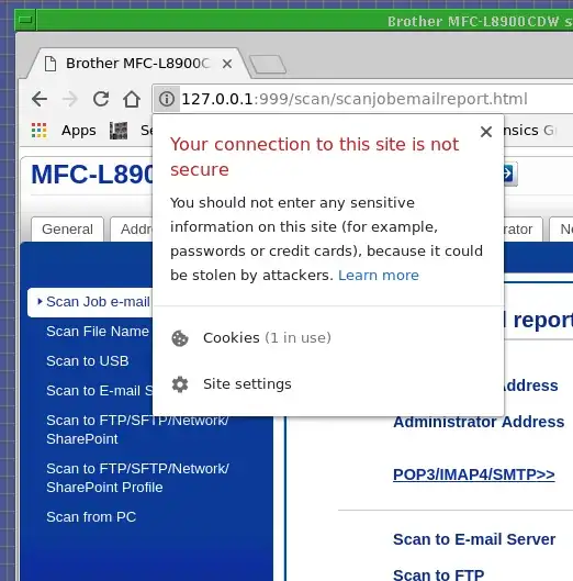

Please walk through how an attacker can intercept Chrome's connection to 127.0.0.1:999, as suggested by the warning below.
This warning is consitently displayed across many versions of Chrome in many OSes.
When I click the "learn more" link in the message, it says that SSL would be more secure, implying that an attacker can intercept Chrome's connection to 127.0.0.1:999. It is established that any user can open a port on 127.0.0.1. However, according to w3.org, only root can open port numbers below 1024. In light of this, how does the attacker pull off the interception in this case?

There are a number of different points here:
  • only root can open port numbers below 1024: that is true on most Unix-like OSes such as Linux. But any user can open any port on a Microsoft system, or macOS since version 10.14
  • an attacker can intercept Chrome's connection to 127.0.0.1:999: well 127.0.0.x is the loopback address. That means that for the attacker to intercept the connection it has to be already active on the local machine. Said differently, the interception could be a way to gather information to prepare a privilege elevation, but in any case for the attack to start, the local machine has to be already compromised
Google Chrome was written from the beginning as a browser and assumes that the client and the server could be on different systems. For that reason, it always throws warnings when it sees the raw HTTP protocol (in fact, any time there is no HTTPS certificate). But only you can say whether you actually trust your local network or your local machine.
What I mean here is that IMHO using https on a local machine adds little to no security: if the machine is compromised you should not trust anything because both the client and server side are compromised, and if it is not, no interception is possible...

While for listening a port<=1024 usually root privileges are needed, sniffing the traffic on this port might still be possible. But sniffing traffic is all what is needed in order to extract sensitive information like passwords from unprotected (plain HTTP) traffic.
It is not uncommon that non-root users are given the permissions to run tcpdump or similar sniffers for example using sudo, because this is needed as part of their work.

There are tools for device Brother MFC L8900 CDW installed on your PC. They are listening to the port 999. Either you or somebody else with root privileges has installed them.
I suppose that these tools generated a self signed certificate. When you access web application that uses self signed certificate, browsers display a warning, which is normal. In case you access this computer from some other computer via network that you don't control, then really there can be a man-in-the-middle that intercepts your traffic, and if you don't check displayed fingerprints, you may accidentally accepts a certificate from the man-in-the-middle.
As long as you access this tool from the the same computer only, i.e. via localhost, I don't see any security risks.

    It doesn't look like a self-signed certificate to me; that looks like HTTP traffic. – wizzwizz4 Dec 03 '22 at 17:33
  • @wizzwizz4 Correct, the image I posted shows plain HTTP. Nonetheless, mentallurg's points still stand, and the software actually supports both HTTP and HTTPS. Chrome's warning is much louder if I connect using HTTPS. – personal_cloud Dec 03 '22 at 17:40
