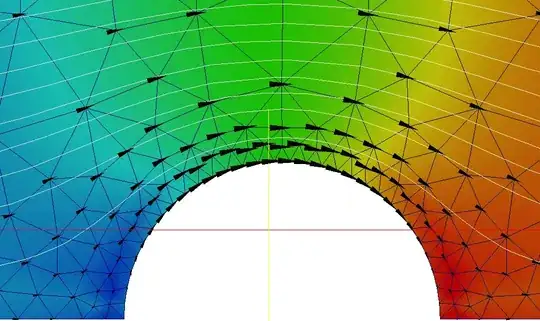

You can use a Nitsche-type method for this. See the following reference:
J. Freund, R. Stenberg. On weakly imposed boundary conditions for second order problems. Proceedings of the Ninth Int. Conf. Finite Elements in Fluids, Venice 1995. M. Morandi Cecchi et al., Eds. pp. 327-336.
I have implemented this a while ago in some simple FEniCS-Code to deal with free-slip boundaries in general 2d geometries. Find the demo code here and the mesh here (tested with FEniCS 1.3).
Cylinder bump: free-slip boundary conditions via Nitsche's method
Update: Meanwhile, others have made similar implementations available. See for instance this github repository.
