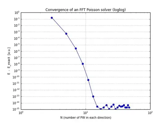

However, one can try a more difficult density, for example:
     nr = 3*pi*exp(sin(pi*x)*sin(pi*y)*sin(pi*z))/4
then the convergence is exponential, as expected. Here are the convergence graphs for this density: enter image description here enter image description here
