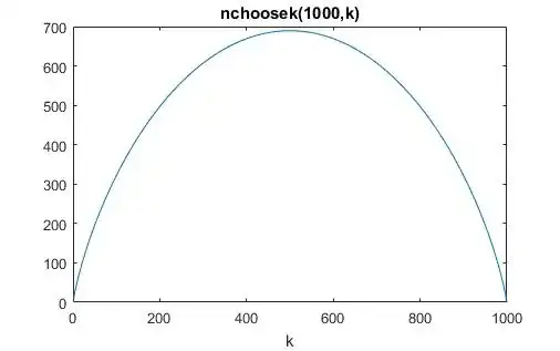

Exploring the entire space of binary variables would take $O(2^N)$ time, so we know that modest increases in $N$ can have, in the worst case, an exponentially detrimental effect on wall-time. The reason we're able to explore spaces of $N=100$ or so is that our MISOCP solver (XPRESS) is able to cleverly prove that certain combinations of points will never be optimal and, therefore, doesn't have to explore them.
The number of points included might have a U-shaped effect on wall-time. If we call the number of points we want included in the ellipse $k$, then there are $$ {n \choose x} = \frac{n!}{r!(n-r)!} $$ unique combinations to check. This equation has a parabolic shape
n choose k
implying that the most challenging problems will be for intermediate numbers of points include in the ellipse.
Intuitively, this makes sense. If we have 100 points and want 99 included in the ellipse, then the problem is easily solved by looking at $O(N)$ solutions. If we have 100 points and want only 1 included, then the problem's solved in $O(1)$ time by simply choosing any point.

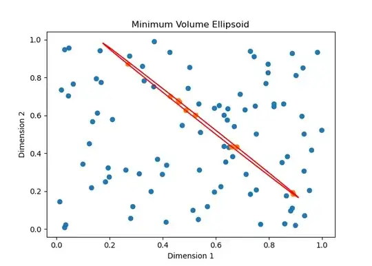

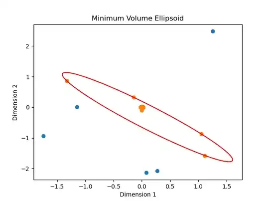

As a quick sanity check we generate a dispersed cloud of data with a large number of points near the middle. Any ellipse excluding a small enough number of points should include the dense region. This is implemented in the sanity_check() function below.
Sanity check
We can then run for various problem sizes:
N=100, Include=80
N=100, Include=80
N=100, Include=20
N=100, Include=20
N=100, Include=10
N=100, Include=10
N=50, Include=20
N=50, Include=20
The wall-times for these results running on a 12-core Intel(R) Xeon(R) E-2176M CPU @ 2.70GHz were
  N Include Wall-time
100      80       32s
100      20     5325s
100      10      909s
 50      20       62s
this roughly matches the intuition we developed with the theory, though it's surprising that (100,80) takes much less time than (100,20) despite the number of combinations to be considered being nominally equal. This indicates that if we want to understand the problem better, we'll need to think harder about the theory.
