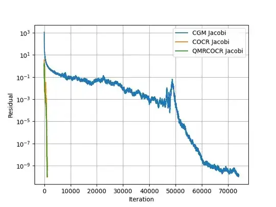

Here are some images of the the curves $||r_n||/||b||$ for solving my problem using the Conjugate Gradient method (CGM) of $\boldsymbol{A}^H\boldsymbol{A}$, of the COCR method of the complex linear system and of the QMRCOCR method. I only used simple Jacobi preconditioning. It is a simple example for a small $\boldsymbol{A}$ of shape $6930 \times 6930$.
CGM is bad in this case Figure 1: Clearly, CGM of $\boldsymbol{A}^H\boldsymbol{A}$ is bad in this case.
COCR and COCR Figure 2: COCR and QMRCOCR both converge in 1132 and 1136 iterations, respectively. Clearly QMRCOCR is more stable.
enter image description here Figure 3: The issue for me is that the residuals of neither COCR or QMRCOCR are guaranteed to decrease in the first iterations. For CGM it does decrease.
So is there a way to guarantee at least 2 first steps of a decreasing residual for COCR or QMRCOCR? I thought the first step of these types of methods was always similar to a gradient descent. Maybe for complex matrices, things work differently?
