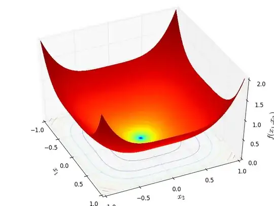

2D representation of the test functions from my work on Global Optimization:
Rosenbrock http://infinity77.net/go_2021/scipy_test_functions_nd_R.html#go_benchmark.Rosenbrock: Rosenbrock
Wavy
http://infinity77.net/go_2021/scipy_test_functions_nd_W.html#go_benchmark.Wavy: Wavy
Alpine
http://infinity77.net/go_2021/scipy_test_functions_nd_A.html#go_benchmark.Alpine01 Alpine
Brown
http://infinity77.net/go_2021/scipy_test_functions_nd_B.html#go_benchmark.Brown Brown
DixonPrice
http://infinity77.net/go_2021/scipy_test_functions_nd_D.html#go_benchmark.DixonPrice DixonPrice
Griewank
http://infinity77.net/go_2021/scipy_test_functions_nd_G.html#go_benchmark.Griewank Griewank
Enjoy :-)
