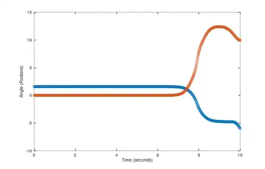

I wish to simulate the behaviour of a double-pendulum-like system. The system is a 2-degrees-of-freedom robot manipulator that is not actuated and will, therefore, behave mostly like a double-pendulum affected by gravity. The only main difference with a double-pendulum is that it is composed of two rigid bodies with mass and inertia properties at their centers of mass.
Basically, I programmed ode45 under Matlab to solve a system of ODEs of the following type:
$$ \left[ \begin{array}{cccc} 1 & 0 & 0 & 0\\ 0 & M_{11} & 0 & M_{12}\\ 0 & 0 & 1 & 0\\ 0 & M_{12} & 0 & M_{22} \end{array} \right] \left[ \begin{array}{c} \dot{x}_1\\ \dot{x}_2\\ \dot{x}_3\\ \dot{x}_4 \end{array} \right]= \left[ \begin{array}{c} x_2\\ -V_1-G_1\\ x_4\\ -V_2-G_2 \end{array} \right] $$
where $x_1$ is the angle of the first body with respect to the horizontal, $x_2$ is the angular velocity of the first body; $x_3$ is the angle of the second body with respect to the first body, and $x_4$ is the angular velocity of the second body. All of the coefficients are specified in the following code, in the rhs and fMass functions I created.

Notice how I set the initial condition of $x_1$ (angle of the first body with respect to the horizontal) so that the system starts in a completely vertical position. This way, since only gravity is acting, the obvious outcome is that the system should not move at all from that position.
NOTE: in all of the graphics below, I plotted the solutions $x_1$ and $x_3$ with respect to time.
ODE45
When I run the simulation for 6 seconds with ode45, I get the expected solution with no problems at all, the system stays where it is and does not move:
However, when I run the simulation for 10 seconds, the system starts moving unreasonably:

Normally, the obvious outcome of these simulations would be that the system stays at its initial position since nothing is perturbing it. Why is this divergence occurring? Does it have something to do with the fact that these type of systems are chaotic in nature? Is this a normal behavior for ode functions in Matlab?
