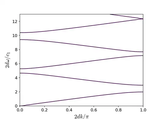

I would say that you can find the dispersion equations in the form $\omega = f(k)$ or vice-versa $k = g(\omega)$, they are not exactly equivalent. In the second form you can find complex wavenumbers. They are real for a region with propagation modes, imaginary for a region without propagation (bandgap), and they are complex for regions with attenuation.
I think that @Kirill answer is the best approach. Nevertheless, I have used another approach in the past. We can write our dispersion equation as
$$F(\omega, k) = 0\, ,$$
where we want to find all the points in a region $[0, \omega_\max] \times [0, \pi/R]$ that satisfy this relationship. If we consider a grid over this region, we can use an algorithm like marching squares for this purpose. Similar algorithms are used in contour plotting routines.
I would illustrate this approach for the dispersion relation of a bilayer material:
$$\cos(2dk) = \cos\left(\frac{\omega d}{c_1}\right)\cos\left(\frac{\omega d}{c_2}\right) - \frac{(\rho_1 c_1)^2 + (\rho_2 c_2)^2}{2\rho_1 \rho_2 c_1 c_2}\sin\left(\frac{\omega d}{c_1}\right)\sin\left(\frac{\omega d}{c_2}\right)\, ,$$
where $2d = R$, $c_i$ the speed for layer $i$, $\rho_i$ the density for layer $i$.
The following (Python) snippet does the job.
from __future__ import division, print_function
from numpy import linspace, sqrt, pi, sin, cos, meshgrid
import matplotlib.pyplot as plt
plt.rcParams["mathtext.fontset"] = "cm"
plt.rcParams["font.size"] = 12
def lhs_dispersion_bilayer(omega, d, c1, c2, rho_1, rho_2):
    factor = ((rho_1*c1)**2 + (rho_2*c2)**2)/(2*rho_1*rho_2*c1*c2)
    return cos(omega*d/c1)*cos(omega*d/c2) - factor*sin(omega*d/c1)*sin(omega*d/c2)
d = 0.5
mu_1 = 2.76e10
mu_2 = 3.47e10
rho_1 = 2770
rho_2 = 8270
c1 = sqrt(mu_1/rho_1)
c2 = sqrt(mu_2/rho_2)
omega = linspace(0, 13, 101)*c1/(2*d)
k = linspace(0, pi, 101)
k, omega = meshgrid(k, omega)
FS = cos(2*d*k) - lhs_dispersion_bilayer(omega, d, c1, c2, rho_1, rho_2)
plt.contour(k/pi, 2*d*omega/c1, FS, [0])
plt.xlabel("$2dk/\pi$", fontsize=16)
plt.ylabel("$2d\omega/c_1$", fontsize=16)
plt.ylim(0, 13)
plt.savefig("bilayer_disp.png", dpi=150)
plt.show()
And we obtain the following, that is correct.
The same approach can be done in MATLAB, or other programming languages. The solution depend on how fine is the mesh. Also, the results from this approach can be used as seeds for a Newton-Raphson iteration, if high precission is required.
