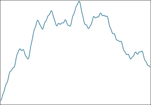

I wish to estimate $\int_0^1f(t)\, \mathrm{d}t$ for: $$ f(t) = \sum_{i=1}^{k} \frac{\sin(ω_i t-φ_i)}{ω_i},$$ with $φ_i∈ [0,2π]$ and $\log{ω_i} ∈ [1,1000]$. A typical function looks like this:
superimposed sines
I chose this function for the following properties:
  • It can be integrated analytically for a control result.
  • It has fine structure on a level that makes it impossible to capture all of it with the number of samples I am using ($<10^2$).
  • It is not dominated by its fine structure.
