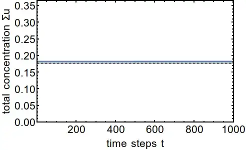

1d diffusion equation
Integrating the diffusion equation,
$$ \frac{\partial u}{\partial t} = D \frac{\partial^2 u}{\partial x^2}, $$
with a constant diffusion coefficient D using forward Euler for time and the finite difference approximation for space,
$$ u_i^{t+1} = u_i^t + D\frac{\Delta t}{\Delta x^2} ( u_{i+1}^{t} + u_{i-1}^{t} - 2u_i^{t} ), $$
leads to the conservation of $\bar{u}=\sum_i \Delta x\, u_i$ over time (see animation 1 and figure 1), because reflective Neumann boundary conditions,$\partial_x u=0$, are employed at the borders (forward differences: $u_i = u_{i \pm 1}$):
$$ u_i^{t+1} = u_i^t + D\frac{\Delta t}{\Delta x^2} \cdot ( u_{i\pm1}^{t} - u_{i}^{t} ) $$
animation_1 figure_2
Space and time are discretized with $\Delta x=0.01$ and $\Delta t=10^{-7}$. The diffusion coefficient is $D=10$.

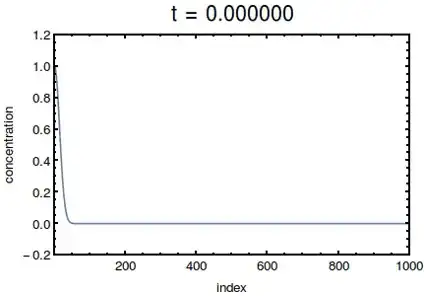

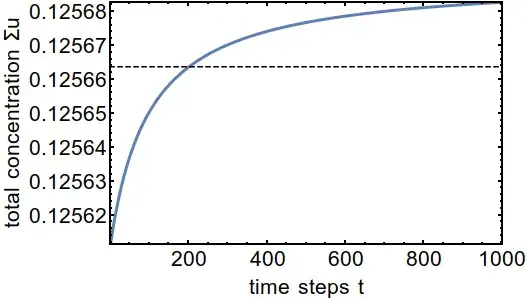

However, there is a problem: Conservation of u is violated (see animation 2 and figure 2).
animation_2 figure_2
Over time the total amount of u grows as calculated via
$$ 2\pi \int_\Omega u(r) r dr = 2\pi \sum_{i=0}^{n} u_i\; (i \,\Delta r) \; \cdot \; \Delta r, $$
where $(i \Delta r)$ is the discretized volume element from 2d polar coordinates. The dashed line gives the analytical result and the regular line the numerical result. Numerical parameters $\Delta r=\Delta x$, $\Delta t$ and $D$ are as before.
Question
Why is conservation of u violated when going from the 1d system to the 1d radial (reduced from 2d polar coordinates)? What can I do to regain the conservation?
Finite volume methods lead to the same discretization scheme as shown above. Robin boundaries (as used for conservation in advection equations) are not applicable, since the flux $j$ at the boundaries is given by $j=r\partial_r u$, which leads to the already employed Neumann boundary conditions $\partial_r u=0$ at $r=0$ and $r=r_{end}$.

You may want a method that works right down to the coordinate singularity at $r=0$. I will do the spherical case, but the cylindrical case is similar. We want to avoid ever dividing by $r$. To think of a Finite Volume method, consider the control volumes to be concentric shells. The inner and outer radii of shell i are $(r_i-\Delta r/2, r_i+\Delta r/2)$, containing an amount of heat $$4\pi\left((r_i+\Delta r/2)^3-(r_i-\Delta r/2)^3\right)u_i=4\pi\Delta r(3r_i^2+\Delta r^2/4) \;u_i$$
Now take the first "shell" to have $r_0=\Delta r/2$ so that it is actually a little sphere of radius $\Delta r$, whose volume is given correctly by $4\pi\Delta r(3\Delta r^2/4+\Delta r^2/4)=4\pi\Delta r^3$. The control volumes are separated by interfaces that have surface area $$S_{i+1/2}=4\pi/3(r_i+\Delta r/2)^2$$ carrying heat fluxes $D(u_{i+1}-u_i)/\Delta r$.
You should find that this all works out. The secret of conservation in non-Cartesian coordinates is to to define carefully the non-overlapping control volumes and then to do the geometry without any approximation.

Your diffusive equation leads always to the conservation of energy in your spatial domain if Neumann BC are imposed. This is natural because there is no heat flux through walls (analogy to heat equation). Therefore integrating our equation whatever coordinate system is used leads to this conservation. For example in cylindrical coordinates: $$\frac{d}{d t} \int_{\Omega}{ur\,dr}= r\frac{\partial u}{\partial r}\hat{n}\bigg|_{\partial \Omega}=0 $$
Finite element/volume schemes in 1D leads to finite differences schemes. Make sure it coincides with: $$\frac{\partial u_i}{\partial t}=\frac{D}{\Delta r^2 }[u_{i-1}-2u_{i}+u_{i+1}+\frac{\Delta r}{2r_i}(u_{i+1}-u_{i-1})] \qquad i=2,...,N-1$$ And for the first and last nodes: $$\frac{\partial u_i}{\partial t}=\frac{2D}{\Delta r^2}(u_{i+1}-u_i) \qquad i=1$$ $$\frac{\partial u_i}{\partial t}=-\frac{2D}{\Delta r^2}(u_{i}-u_{i-1})\qquad i=N$$
