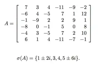

However, when trying to solve companion matrices to retrieve the eigenvalues, I find it often gets things wrong. Even their example results with a $6 \times 6$ couldn't solve for all the eigenvalues:

  • The 2x2 block of H(11) that you've circled in red has eigenvalues of 1+-2i as expected. What do you think is wrong with this? – Brian Borchers Aug 04 '16 at 19:07
  • @BrianBorchers You must excuse me since I'm really not used to this sort of thing, but I thought it would be like the 5 (+/-) 6i, where it would be shown as a: {{1, 2}, {-2,1}} block. I suppose I am expected to retrieve it from this 2x2 block by solving for the eigenvalues instead of reading it off. I feel quite stupid having not thought of solving for the eigenvalues of the 2x2. – Micrified Aug 04 '16 at 19:22
    It's pure luck that the upper left 2x2 block worked out the way it did. – Brian Borchers Aug 04 '16 at 21:34
  • Thank you. I didn't realize this. It's very helpful. If you can write it as an answer I could accept it. – Micrified Aug 05 '16 at 07:29
The matrix given as H(11) in your question actually does have the expected eigenvalues of $1 \pm 2i$, $5 \pm 6i$, $3$, and $4$. In particular, the eigenvalues of the 2x2 block circled in red are $1 \pm 2i$.
It's a matter of pure luck that the 2x2 block in the upper left has the form that it does, making it obvious that its eigenvalues of $5 \pm 6i$.
Brian Borchers
