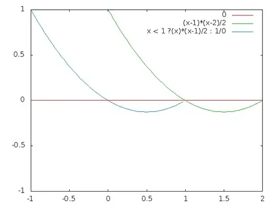

This is how my functions are overlapping on $[0,1]$ (so for example $1-x^2$ has support on two elements). centered functions left sided functions right sided functions
So there are six functions on each interval and three on each node, just as the graphic linked above. But there the interval $[0,2]$ is used, so that the $1-x^2$ function is $0$ outside with some inner node not belonging to other elements, while i have only nodes on the limits of the elements, so the function has support on two elements as well.
