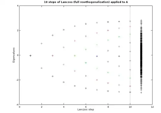

The convergence behavior you are seeing is actually expected. One of things that makes the Lanczos method so interesting is that it does a good job of simultaneously converging eigenvalues at both ends of the spectrum.
I assume your expectation of converging only the largest eigenvalues is based on the fact that, as expected from the Power iteration method, the last Lanczos vector is getting closer and closer to the eigenvector corresponding to the largest eigenvalue. But remember, each computed eigenvector is actually the "best" linear combination of all the computed Lanczos vectors. And, if you start the Lanczos process with a random vector, this vector is as good an approximation to the lowest eigenvector as the largest. That the largest eigenvalues do converge somewhat faster than the smallest, however, is consistent with what you would expect from Power iteration.
Demmel's book, Applied Numerical Linear Algebra, has a nice discussion of the convergence properties of the Lanczos algorithm in chapter 7. The plot below is computed with Demmel's Lanczos code and reproduces figure 7.2 in the book.
He computes approximate eigenvalues to a 1000 x 1000 matrix using increasing numbers of Lanczos vectors. The last column of $+$ signs shows all 1000 eigenvalues from the full matrix. (the last two columns in this plot are essentially the same as your plot above rotated 90 degrees). But this plot also shows that the distribution of the eigenvalues across the spectrum is not accidental; the eigenvalues at both extremes are converging monotonically to the extreme eigenvalues of the full matrix.

    excellent answer. one minor comment: if $A$ is symmetric, the (real) spectrum is symmetrically distributed w.r.t. $( \lambda_\max + \lambda_\min) / 2 $ and one uses a random initial vector (just like the OP's and Demmel's setup), Lanczos converges just as fast to the maximum and minimum eigenvalues (as you show in your plot). For complex spectra, or eigenvalues that are not "equally well separated", you start noticing differences in the convergence speed. – GoHokies Mar 06 '17 at 18:34
  • @GoHokies In my experience, the smallest eigenvalues always converge slower than the largest and I thought this was the nature of the algorithm. I'd like to understand better what you're saying. – Bill Greene Mar 06 '17 at 23:57
  • aha, so perhaps I had wrong notion that Lanczos is method of choice if I need to find accurate approximation for the first N eigenvalues of system with M eigenvalues (where N<<M) by doing ~N rather than ~M iterations. Can you just correct me what I should search for ? – Prokop Hapala Mar 07 '17 at 06:48
  • As you can see from the plot, the smallest eigenvalues do converge-- just slower. So as @ChristianClason noted in his comment you may need to use $2N$ or $3N$ or more vectors/iterations to compute $N$ of them. Alternatively, what is often done in practice, is to apply the Lanczos algorithm to $A^{-1}$ instead of $A$. This quickly converges the smallest eigenvalues and is analogous to the inverse power method. Of course, just as in inverse power, you solve equations rather than computing the inverse. – Bill Greene Mar 07 '17 at 13:55
    @BillGreene what i mean is: Demmel's diagonal matrix elements (the eigenvalues) are sampled from a symmetric Gaussian distribution, hence they are (almost) equi-distributed around $\frac{1}{2}(\lambda_\min + \lambda_\max)$ (see figure 7.1 in his book). Because of this symmetry the Lanczos algorithm does not favor either end of the spectrum, and you notice equal rates of convergence for both the smallest and the largest rates of convergence. Suppose you break this symmetry by modifying Demmel's code to sample the diagonal elements from, say, a lognormal distribution... – GoHokies Mar 07 '17 at 21:01
    ... then the behavior of the Lanczos routine should be what you expect bc a large fraction of the eigenvalues will be clustered around the lower-end of the spectrum, while the dominant (largest-magnitude) eigenvalues will be well isolated and will converge fastest. – GoHokies Mar 07 '17 at 21:01
  • @Bill Greene > but if I want to get e.g. 1/4 of all (N) eigenvalues it is not worth to run Lanczos with number of iteration M=3*(N/4) because than the size of resulting matrix is almost the same as size of original matrix. In addition, from experimentation I see that after 20 iterations I still get just first ~ 3-5 eigenvalues correct. – Prokop Hapala Mar 10 '17 at 13:38
  • @Bill Greene > You can see also from you plot - after 10 iterations you got approximation of just 1 or 2 eigenvalues (and even that quite imprecise) – Prokop Hapala Mar 10 '17 at 13:44
  • If you want a significant number of the lowest magnitude eigenvalues, this problem is usually handled by applying Lanczos with shifts to the "inverted" matrix, i.e. $[A-\mu I]^{-1}$. The most effective approaches use some strategy to select a sequence of shift values to speed convergence. I strongly suggest you not try to develop your own eigensolver. Take a look at, e.g. Arpack. – Bill Greene Mar 10 '17 at 13:49
  • My comment was based on the assumption that you want the smallest magnitude rather than largest magnitude. If you are looking for guidance on how to solve a particular class of eigenvalue problems, a new question with a lot more detail on the problem type is probably appropriate. The current question really is about certain theoretical aspects of Lanczos. – Bill Greene Mar 10 '17 at 14:06
