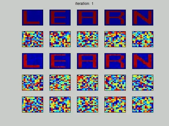

Just to summarize the answers given for this question, here I provide a visualization of different methods carried out to learn the projection matrix $A$ given clean samples $X_i$ and noisy samples $Y_i$:
learning the projection matrix using different methods: first row: original matrix for 5 different cases, second row: initialization of the matrix, third row: using normal equation, directly derive the projection matrix, fourth row: linear regression using gradient descent and finally, fifth row, using kalman filtering
In the first row we can see 5 different projection matrices ($A$) chosen to project $X$ before adding Gaussian noise $N$.
In the second row, you can find the random projections initialized to be learned via different methods.
Third and fourth rows are related to a solution suggested in here.
In the third row, using the normal equation, we directly derive the projection matrix: $$ \hat A = (X^T \times X)^{-1} \times X^T \times Y$$
In the fourth row, a linear regression using gradient descent is used to learn the projections via $X$ and $Y$.
And finally, the last row, using kalman filtering method suggested by choward.
As you can observe, the GD solution and the normal equation are very similar and since in this example, $(X^T \times X)^{-1}$ is feasible to calculate, it sounds a more reasonable solution and can be done in only one step. If the dimensionality of our features were too high, then we can use the GD since both $X$ and $Y$ are Gaussian.
The KF solution converges faster than GD, but can not achieve a good performance as GD, I believe.
After learning $A$, $N$ can be calculated via: $$\hat N=Y- \hat A \times X$$
and further $\hat {\mu_N}$ and $\hat {\Sigma_N}$ can be computed using $\hat N$.

    Cool visual! I will have to implement a gradient descent and see how it compares. I should say that if you just try to estimate just $A$ first, the KF does better (tried it this morning). I also believe you could tune the KF to be better than the one I implemented (I didn't really tune it). But nonetheless, cool visual and result! – spektr Jan 28 '16 at 16:02
  • @choward thank you! you should try the regression solutions. I guess since my problem is much easier than a time-dependent problem with no Gaussian assumption, regression can solve it easily. Kalman should be more powerful in more difficult situation. e.g. a time serrie from an unknown distribution.
    Maybe you are right, maybe kalman also can be optimized. anyways, enjoyed a lot working on this question and learned about kalman filters power from you!
    – PickleRick Jan 28 '16 at 17:02
