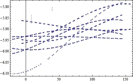

Using an instrument, we are monitoring the trajectory of several objects during a period of time. We take a lot of measurements of the position of the objects in the field of view of the instrument, so we have a list of triplets composed of (time, X, Y). Usually there are several objects in view, so we have several positions for the same time.
We already have an algorithm that can reconstruct the trajectory of a single object if you give its measurements, however, this algorithm won't work if several objects are provided at the same time. So we are looking for an algorithm to first classify the different observations in different objects.
Here is an example of an easy problem, plotted in 2D, containing two objects. It seem they cross paths but actually they approach at different times so it should be possible to classify them without confusion. Sometimes the objects will really cross paths at the same time (get really close). In that case, it is better just to discard the points near the encounter than get some points wrong.
two objects
Some other scenarios are much more complicated, but it would be OK to discard points from different trajectories that are very close in position and in time. Trajectories can be curved lines, and in fact, almost always they are smoothly curved lines:
multiple objects
Any hint on how should I approach this problem?

  • What are those gaps? Is it one object moving especially quickly in those? Or is it not observed? Is the number of objects fixed? – Kirill Aug 01 '15 at 01:11
  • The gaps are from the observation, due to the download time from the camera or sensor movement, but the actual object speed is very stable, it may vary but very slowly. The number of objects is unknown a priori, it may be from one to about 50, but usually is below 10. – siritinga Aug 01 '15 at 09:21

  • Wow, thank you very much for this lengthy and detailed explanation. Your approach certainly looks very promising but I'm afraid I don't have the expertise to follow and implement it. However, I will make the effort, and I think that a similar approach can be applied to some other (similar) problems we have to solve. I have implemented a deterministic approach of predicting the position in the future depending on past classifications (starting with a greedy position algo) and taking the closest candidate, it works moderately well except in cluttered sections. – siritinga Aug 04 '15 at 09:34
  • @siritinga I hope I didn't make it sound too complicated. There's a bit of jargon, due to this coming from a different field than pure numerical analysis, but it's really not bad. Cluttering is the sort of situation where you need to backtrack a little to properly minimize the sum of squared errors and where a greedy method wouldn't work so well. – Kirill Aug 04 '15 at 17:29
