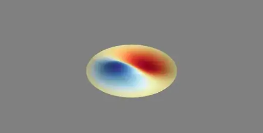

I think that you have two problems:
  • your timestep is too big (the CFL condition is not satisfied); and
  • you are not updating the values for $\phi=2\pi$.
I am not sure about the CFL condition for polar coordinates, but I believed that it should be $$2c\frac{\Delta t}{\Delta r \Delta \phi} \leq C_\max \enspace ,$$
what implies that $\Delta t < \frac{\Delta r \Delta \phi}{2c}$.
Regarding the values for $\phi=2\pi$, you need to update for $\phi=0$ and $\phi=2\pi$ although you are not looping until the last angular value.
These things are corrected in the code below (and it works). One thing that is not working terribly good is the solution for $r=0$... but I have no ideas now on how solve it. But I think that it needs to be solved as a particular case.
I attach some images for the mode $(1,1)$ of vibration (since I am not good with the animation thing in Python).

Timestep: 0 enter image description here Timestep: 199 enter image description here Timestep: 399 enter image description here Timestep: 599 enter image description here Timestep: 799 enter image description here Timestep: 999 enter image description here
PS: Please, generate videos and share it in the comments (I want to see). And, use a different colormap, the one you used is not so good.

    You are brilliant, absolutely brilliant. Amazing answer. Everything is working. I didn't take into account  3 things:
    1. The time
    2. updating the values
    3. transposing X,Y,Z
    Thanks so much, amazing
    – Henry Kolesnik Aug 02 '15 at 21:27
