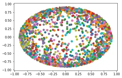

To sample uniformly on a given ball (or other compact set), one could do rejection sampling with the volume form: $$\left(\frac{2}{1-||x||^2} \right)^n \, dx_1 \, \ldots \, dx_n$$
Here's a uniform sample for the ball of radius 3 centered at the origin: enter image description here
If desired, I'd be glad to say more. I just thought I'd put this up, since there was clearly some interest in this, at least in the past.
