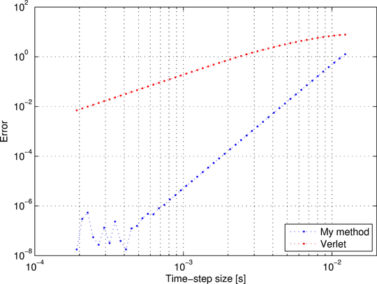

Kepler Orbit
I did a simple benchmark of an eccentric Kepler orbit (eccentricity of 0.75 and 20 orbits) I found that this method seems to be a fifth order method and Verlet, as suspected, a second order method. I derived this from the slope in this log-log plot of the time-step size versus the error (distance between numerical and analytical endpoint): Error of integrator versus time-step size
The actual slopes are $4.98\pm 0.01$ for my method and $1.98\pm 0.01$ for Verlet, where the errors are a 95% confidence bound.
