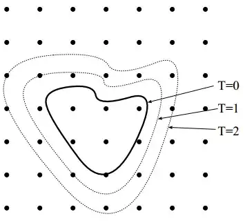

The Fast Marching Method is a way of solving the Eikonal Equation on a discrete grid, essentially just computing a wavefront speading out from initial points, IE:
Wavefront
The idea is that we want to compute the time at which a wavefront, moving across a field with a velocity function $F(x, y)$, reaches each point in a grid, IE:
