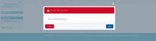

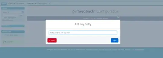

I just went through this exercise for a basic configuration page. Here is what I found out for a basic example:
  1. Liberal use of Javascript Remoting in place of submit elements (commandButton, commandLink, etc) along with calling actionfunctions in the handler to perform partial page refreshes
  2. Two VF Pages were required in order to show the page within Classic and inside LEX if you want the header or sidebar in classic:
     <apex:page showHeader="true" showSidebar="true">
         <apex:include page="LEXPAGENAME"/>
     </apex:page>
  3. You sill have to create your own JS to control the when and how to display elements like alerts / modals / etc. Some you can do with class names, other you have to use css. jQuery is helpful.
  4. I used a mix of mostly html tags with the occasional outputPanel with render attributes.
Doing it this way created a page that displayed and worked both inside of Classic and LEX as expected.
NOTE None of this used the Lightning Component framework and DID use the SLDS but it did "look" like lightning. If you are going to use Lightning Components you will have to do the lightning check and do double work to have it work in both UI's. Seems the interim is to make VF "Look" like lightning for now
Example of the same Wrapper page with embedded SLDS Page shown in both Classic then LEX
Classic enter image description here enter image description here enter image description here
LEX
For both UI's simply use the main wrapper page. In LEX it will strip off the header and sidebar automatically. So while you need a Wrapper page and a child page you only use the wrapper page in the tab..
