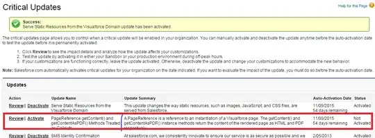

  • because, the only rational answer is that particular critical update is not yet applied in sanbox but it was applied in production. Can you search in 'Quick Find' for critical updates and check ? – Amit Bangad Jul 20 '15 at 10:37

I strongly believe this has to do with getContent() and getContentAsPDF() method. This was a critical update from salesforce which seems to be activiated in your production and not in sandbox so test class work fine in sandbox but not in production. This update basically considers the above two methods as callouts as opposed to regular method before. So the only solution I can think of is try implementing a Mock as opposed to these methods or just apply check of
if(!test.isrunningtest())
to ensure that these methods are called only in regular context and not in context of test class.

  • First of all are you using any of these 2 methods i highlighted? – Amit Bangad Jul 20 '15 at 10:45
  • Yes. I am using getContentAsPDF() – Nihar Jul 20 '15 at 10:45
  • So now you CANNOT directly call that method in your test class context. You will have to either implement a mock or apply the check in original class (not test class) as I mentioned in my Answer above. If you need more inputs please post your method too. – Amit Bangad Jul 20 '15 at 10:53
  • Amit I have done. Thank you so much for your great valuable time and Answer. – Nihar Jul 20 '15 at 11:17
